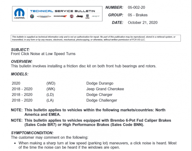

Hi Boricuoso787 and SDREDEYE,
We sincerely regret to hear of all the trouble. Please see the attached document to view a Service Bulletin that may address your concern. We recommend visiting your deal to get this repaired.
Rob
Dodge Cares

Fail...

Wait.... What?
