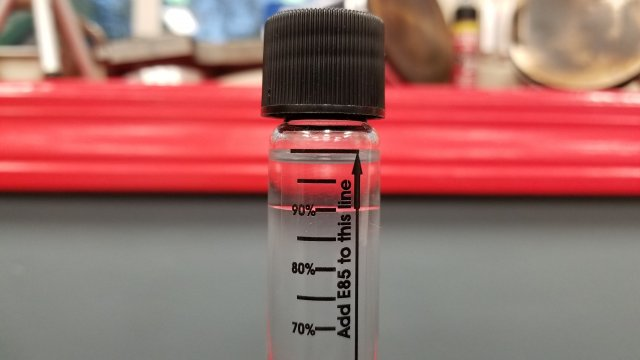

1. Test as often as you can. Not just to determine ethanol content but more importantly to visually inspect the test specimen before filling the tank. I have purchased e85 at a number of different stations that tested anywhere from e75 to e90. My cars have run fine on them all. Here is the concern. Some test samples have almost an opaque white color. Some had what looked like little worms in them. On occasion I would leave the specimen in the tube for a week or longer. The opaque specimen would accumulate some crud, almost like puss in the bottom of the test tube. I worry that this fuel, even though it would test 85 could restrict a fuel component or injector and cause an engine failure. I believe a significant number of engine failures are not necessarily due to fuel that doesn't test high enough, but for fuel that test right but impedes the performance of fuel, injectors, lines, or pumps. I wanted to introduce this specific aspect of testing as it is rarely ever discussed.

We have 3 fuel "brands" around here that carry E85. Thortons, Racetrack, and Speedway. I tested all three and Speedway tested higher at E83 in March where the others were E70. I also noticed what you mention, the Speedway was crystal clear like moonshine clear, and the others had kind of a more cloudy and yellow tint. Speedway has a reputation around here for being the winner for E85 from the pump so I'll use it exclusively.
I tested a fillup yesterday at E90+ now that it's warming up here.

Yes, we have speedway here also. Their e85 is always clear and I try to buy from them when I can for that reason. Ive purchased from them in winter and it usually test anywhere from e75-e80. In the summer it tests e85-e90. The other brands usually have the opaque matter in the fuel. When I buy that I will only buy what I burn can through in a day or two and also cut it with a gallon or two of 93.

I've noticed that the stickers on the test tubes tend to be haphazardly placed on the tubes, meaning that the lines for percentages can tend to drift around (up or down). Does this seems like a problem, or is the variability not enough to be a problem?

Most of these guys are saying the performance diff is negligible between true E75 and E85 so maybe the 1-3% variation on the tube is nothing to worry about? Still would like it to be accurate though.

I'll see if I can find an old pic of a tube with worms and one with cloudy e85.
Your questions brings me to the second point I was going to make which is this: don't get hung up on the lines on the tube. They ar not %100 accurate. It is not uncommon for a tube to read 7-12% different than an ethanol content sensor. I interpret tube data more so for clarity and content of the specimen than for a specific content number.
