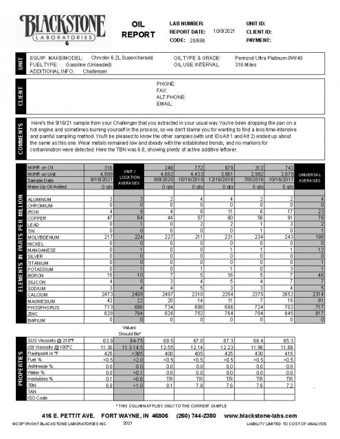

Just for comparison...
(IGNORE the comment about "dropping the pan", I don't do that, they misinterpreted my comments about the oil change process I do.

@BULL so from yours it would appear the break in copper/iron are a thing since yours has so few miles on it and so few on the oil itself. I mainly did this check to make sure my once a year OCI was G2G on E85 and it is no problem. I've had a couple people comment on the video that their older F150 or Ram FFV had comments on shorter OCI when running E85 similar to the towing OCI. I checked a 2016 Caravan, 2019 F150, and 2018 Silverado in my research and none mentioned anything other than Ford calling out to run a tank of gasoline every oil change. Not sure what that would even do over a 5-7K mile OCI though. I'm personally gonna run 1/2 tank of 93 every month just because.

The thing that has driven my crazy change intervals has been that I change oil based on the following starting from new:
At 500 and then 1500 total miles
Then after any "racing" event, or 6 months, or 3000 miles, not that I ever get that far in this vehicle inside of 6 months.
There's a handful of changes that have fallen off the end of the report too.
This last interval, I let it go out to a year because I forced myself to. So few miles, no "events", and so many changes behind it.

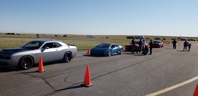

Besides the AWESOME picture of my car, check out the paddock area in the background.... ...sparse...

Yeah way different than TX Mile, it was a circus. Fun as a spectator, but for people running a car not so much. Get to the track before sun up to get the car in the lanes, push, push, push. Wait. Some hot shot gets to go in front of everybody else because they're some speed shop. Wait some more.
