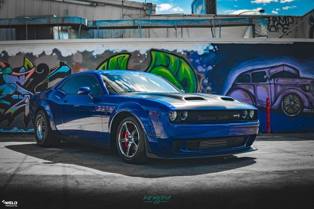

So with the WB RE arriving in the next few weeks I'd like to have a plan as far a street set up goes. Not going to the strip, but would like to have something that wont just light em up and embarrass me when some built Mustang or awd import with a garbage can muffler gets frisky. Loving the 18" set up on the Demon and the new Super Stock but with my bigger brakes in the front it would look goofy with 18's rear/20's front (I think). Assuming that's the case just how sticky are the 20" DR's that most people run? Better to just buy some slightly wider replicas with DR's and do that? Or go with smaller wheels and more sidewall...
I did a search and am still trying to decipher all the info. Most people seem to know what theyre after and so I'm trying to even get that far lol.

Ya def not giving up the six pots. And not wanting to start getting into mods other then a sticky tire/wheel setup. Going to need to see a few pics of 18/20’s just to gauge the look.
