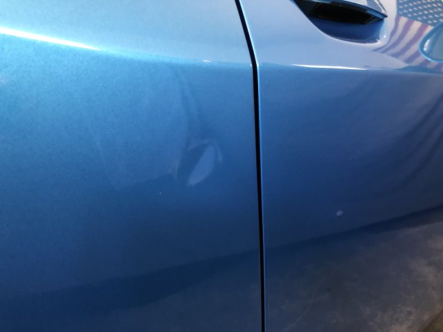

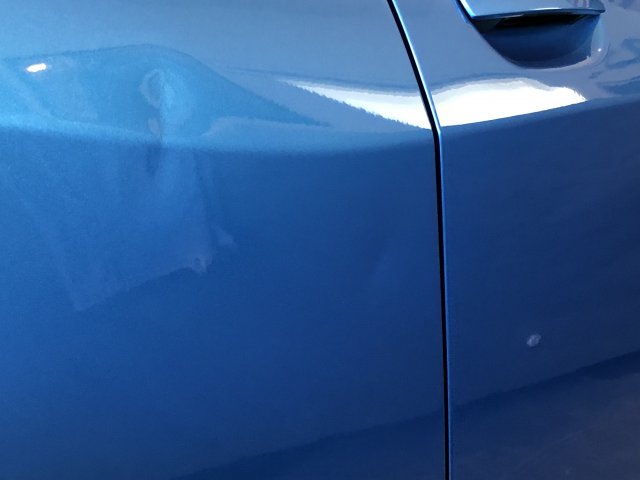

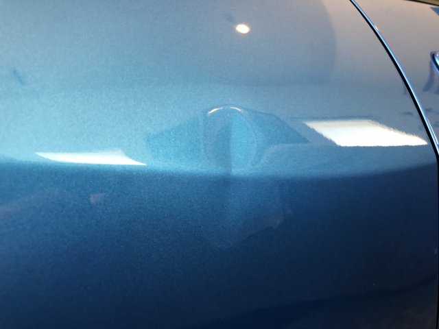

Friggin’ a-hole move on my part caused something to fall on the car. 2 dents right behind the passenger side door. One dent below the body line and one right on the damn thing! I’m so pissed at myself!!! Ive got a great body guy but I hate to worry about paint match. Thoughts please.

Doesn’t look creased too bad, some those guys can really do wonders. I would ask around for the one that is really special at doing it. Some people were just meant to do what their trade is

My opinion (which doesn't account for much), no.
It's on the panel crease.

Probably can make it look better but not perfect. Most won’t even try if it’s on a body line and you know they cannot fix any paint damage if the paint is cracked or scratched. On the other hand, body shops that do insurance work have the right expertise to match your paint. I had a $5,000 rear end collision on my 2013 Billet Silver Daytona and the paint matches perfectly. It has a lot of metallic in it. I think you could get that fixed on your comprehensive coverage rather than collision.

I would get the best paintless dent repair guy i could find and give it a go. If not sufficient, can always do the other.

Key thing is if the can get behind it. They can pop your inside interior panels and if they can get direct access to back of panel, that would help hugely. Problem is these cars are built like tanks and are all double paneled underneath, so it's a roll of the dice if there's access at that point. Also, it is a sharp body line so that's tricky. A good paintless dent guy can do wonders. Good luck.

I've seen good PDR guys work miracles on things I thought needed a body shop. Find a good one with alot of experience and let them try. If your not happy with it you can always go the body shop route with new paint..

Thanks guys. I’m looking into a few pdr guys who only come highly recommended. Ive also got the guy who refinished my Roadrunner, who does great work but I hate to leave the car. Thanks for the vids Bull. Those guys do some work! Ill update you guys as soon as I get it rolling. It sucks!!!

I would have said NO. but if they can fix that in the video. anything is possible with the right guy. Finding Him may be a problem.

Hell its worth a try but that panel crease will make it difficult.

I would say that a good one can get that out. This is definitely a case of you get what you pay for. There are several videos on YouTube of PDR fixing areas like that on Challengers, and show what they have to go through. They have all kinds of weird angled tools to get into places.
I backed into the fender of my Challenger and dented it with the corner of my leaf blower. I went to the best place I could find that had lots of reviews from high dollar car owners. It cost me $160 to get that little dent removed but the guy took his time, and had all the stuff he needed, especially this awesome light that they shine on it that displays lines on the panel. You can instantly see the progress they make.
