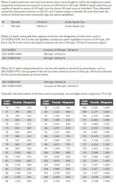

It depends. Do you want to retain the capability to travel in excess of 186 mph safely? I haven't looked much at the 305 stuff yet, but on my old narrow body car I could only find ONE tire, other than the stock offering, that was available in the stock sizing, rated 186+ (as opposed to rated UP TO 186) and also had the correct load rating (load rating on the narrow body is "106" and on the widebody is "107"). That tire was the Michelin PS4 (not to be confused with the PS4S...which I was not able to find in stock sizing). The PS4 had better traction and met all other criteria but developed a terrible back-n-forth oscillation under heavy acceleration when speeds climbed above 80mph. So I went back to the PZero summer tire. I also wanted to stick with the stock sizing because at the time I wasn't interested in changing wheels and I wanted my sidewalls to stand correctly instead of being bulged or poked.
As I said before, I don't know whether another tire exists for the 305 section tire that also has a (107Y) speed/load rating. And that may not matter, to a lot of people it doesn't. But I didn't want to give up that capability so I was in a tight box.
You may already be aware of all of this, but it took me awhile to figure it all out. Hoping the info helps.

Some good information! I've ordered some Michelin Pilot Sport 4S tires for custom wheels for my Hellcat REWB - hopefully they will be shipped soon. Deciding which tires to try on the new wheels was a journey down tire information lane - and while I spent a lot of time looking for whatever reasons I did not read a clear explanation of the nomenclature you've listed pertaining to the load rating, or the speed rating.
I'm getting the 4S tires in front in size 315/30-20 on 11" rims custom designed to accommodate the six caliper Brembo's. This is a little smaller diameter tire than my stock all season Pirelli's. The Michelin 4S tires are labeled 315/30ZR20/XL (104Y) on the michelinman.com webpage. You said the Z is left in there to connote "in excess of 149 mph", and the Y after 104 means "in excess of 189 mph", which is great although I'll never get there. The 104 load rating of 1,984 lbs...well, dang it, you've said my car should have tires with a 107 load rating of 2,149 lbs. These 104 load rated tires do have XL (there are two models for the same size tire - not sure why). I got this below off a website explaining XL;
"Reinforced or XL (Extra Load) tires are specially reinforced tires. They can carry heavier loads than tires of the same size. Reinforced tires are designated on the sidewall by the letters "RF"; extra load tires with the letters "XL." Reinforced and XL tires require higher inflation pressures than standard tires."
Am I making a mistake in not ensuring any new tires have a load factor of 107, or perhaps higher? Does it matter if I'm not going to put four people and a trunk load of stuff in the car? How about running the car hard on a road course? Questions, questions...they never seem to end. Turn over one new to me subject rock and there are ever more questions.
I imagine a sharp lawyer, if I had a blow out on the street and hurt somebody, would say I was negligent in not ensuring I had 107 rated tires on my car.

I think I answered my own question. HJR, you are correct the stock Pirelli 305/35-20 tires on REWB Challengers have a load rating of 107.
But, it was an option to buy the summer Pirelli 305/35-20 tires and they have the 104Y rating.
https://www.tirerack.com/tires/tires.jsp?tireMake=Pirelli&tireModel=P+Zero&partnum=035YR0P0
I must be on solid ground getting any close sized tire with a 104Y rating.
I have the stock summer Pirelli tires on my widebody and they're (107Y).

With regard to the Michelin PS4S tires and that michelinman.com link where I got the 104Y info, I noticed there are TWO listings to "buy" 4S tires - for what would appear to be the same dang tire. They do have different model numbers, but everything else about the tires seems the same. No separate load index ratings on that buy page - the load index ratings if they are different aren't displayed. So what's that all about??
ARE there two models of your summer Pirelli tires - one model rated 104Y and another one 107Y? Why would a company do that? Someone seeking to buy OEM replacement summer Pirelli tires could easily forget about, or not know about, the 107Y rating and buy what looks exactly like their OEM tires on tirerack.com - but rated 104Y. That might present a safety hazard.
There's a PZero summer tire in 305/35/20 with a (104Y) speed/load rating that was developed for Ferrari. Not exactly sure which model. The (107Y) version was developed for the fatass Hellcats that we drive.
The attorney says, "I know cars. Your car specificed 107Y tires."
To be completely accurate........"(107Y) tires". Parenthesis are important in that context. ;)
Those parentheses are critical. That's the "over 186" indicator...
