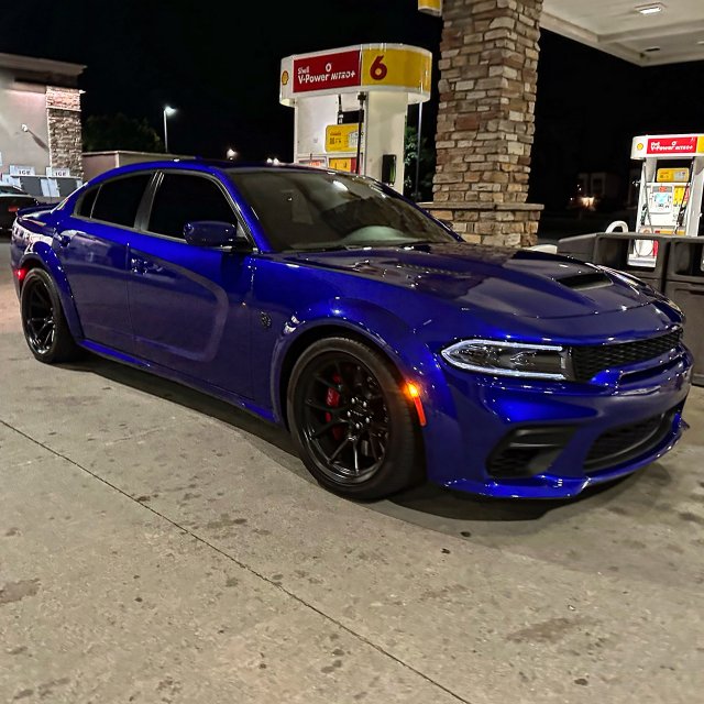

Be careful where you get your cars serviced in Colorado.
Took my 22 Redeye Charger for an oil change at Chrysler Dodge Jeep Ram in Castle Rock Colorado and I presume they started my car without the filter on. Have oil everywhere inside the engine bay. Got home and found a puddle of oil leaking from the skid plate with scratches on the bumper from a lift.
Currently getting a tow to see what they’ll do to remedy the issue.
Whole oil change took about two hours and was told the tech “spilled some oil near the fill cap” They even brought the car back out to me to drive off with a rag covering the air filter.
Just be careful where you get your vehicles serviced everyone!

Beautiful car! No thanks, changing my own oil Saturday matter of fact. Sorry to see and hear what happened OP. I would get to the dealer manager/owner and make them do a lot of things to make your car right. Start by confirming what oil they filled it with it looks so bad!
