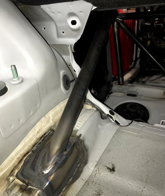

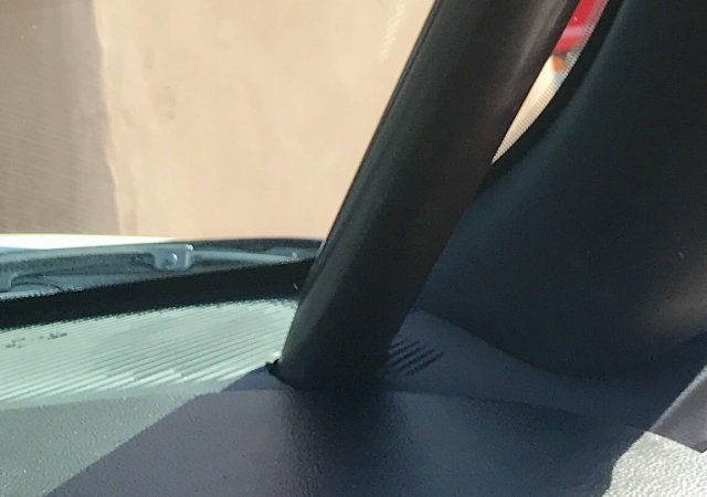

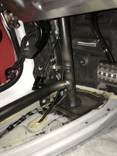

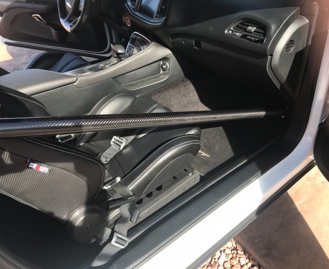

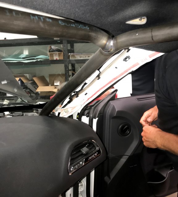

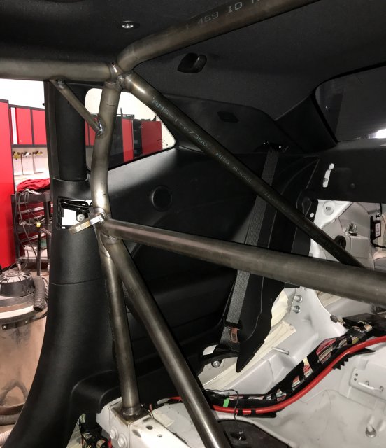

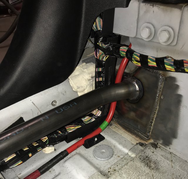

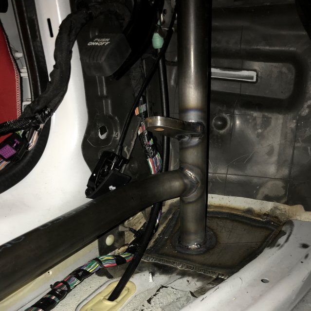

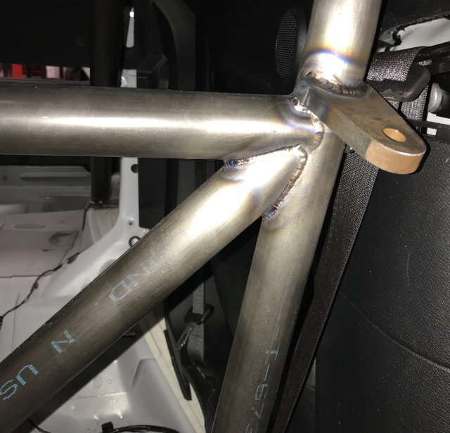

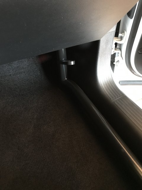

I know there’s a lot of confusion. Here’s what the NHRA tech enforcers like to see when it comes to a “cage”. DF797271-77AE-4092-8F9C-24CA4B5D930F.jpeg 9AA84A67-45DC-41EA-98F2-88EA98548916.jpeg 4148A696-445D-4004-945F-263AE79820BB.jpeg F94ED470-31FB-418B-BF26-7ACDDF6FAD79.jpeg 2A19EE8B-43B5-4255-AEC7-04162BF3C75F.jpeg 95B3DA61-D108-4E3F-853E-2FA2C68A742B.jpeg

I know there’s a lot of confusion. Here’s what the NHRA tech enforcers like to see when it comes to a “cage”. View attachment 13260 View attachment 13261 View attachment 13262 View attachment 13263 View attachment 13266 View attachment 13265
Thank you Marc! that is exactly what I needed to see. Thus, need a full cage.

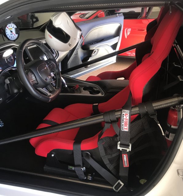

I understand exactly. When I went to the shop to check on having this done I was very concerned about all the potential issues with removing the dash. Will it go back in place without damage? Will it rattle or vibrate? What about all those electrical connections? I asked them about “maybe” doing the in front of the dash approach. No offense to those that have that. His quote.. not mine! He looked at me and said.... “we don’t do half ass stuff like that”. 😂. They removed and replaced the whole interior of the car (including the dash and everything in there) like it was nothing. You can not tell it was ever done. The damage you’re talking about is confined to the narrow strips of plastic that have the speaker vents in them. They are separate from dash and can simply be replaced with new ones if wanted later. These guys didn’t even need to remove the speakers. They are still in there and working. 92C1019A-0C14-4AF8-8B2C-11EA6C39B4B9.jpeg
