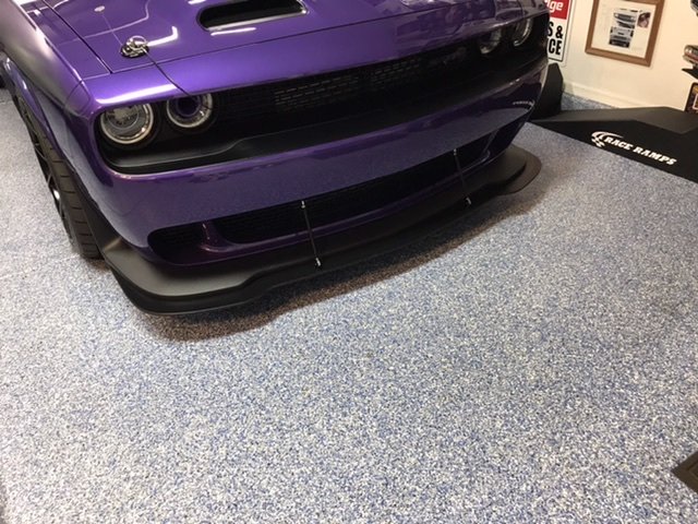

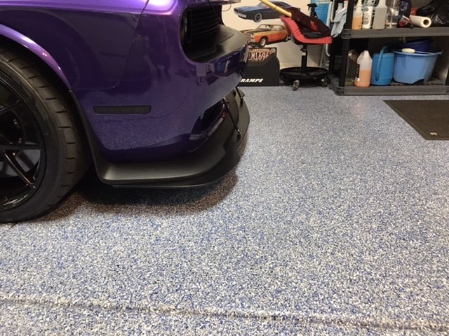

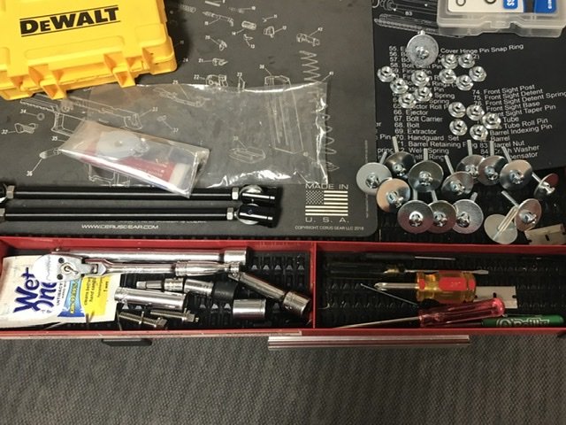

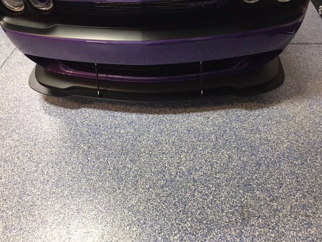

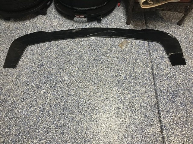

Got pics of the splitter (curious on its look).
Here it is not installed yet. Included a picture of the rods and hardware also.

The splitter guard is about an 1/8" lower than the bottom of the stock splitter circled in red. It also has those metal cones there circled in orange every foot or so that is now the lowest part of the splitter. All that protects the splitter in case you go over a parking stop or something. It does not hide the leading edge or protect it if you run into something higher.

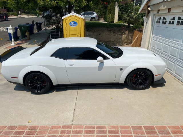

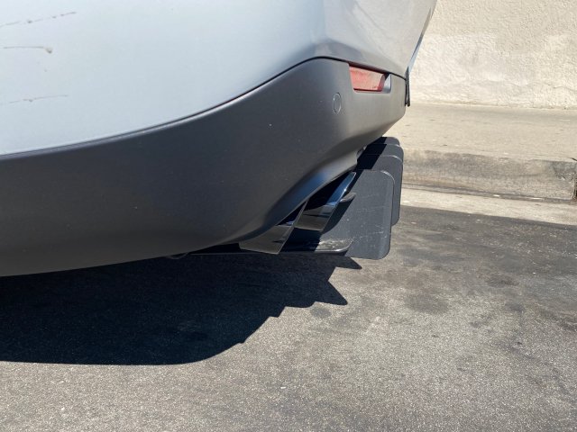

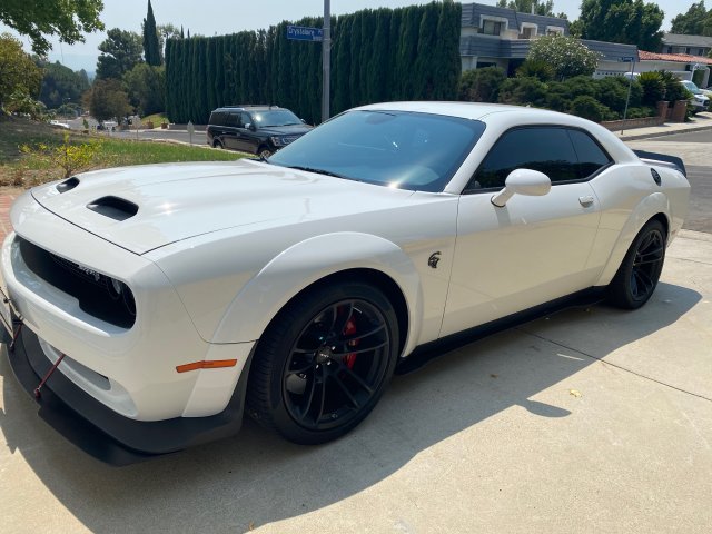

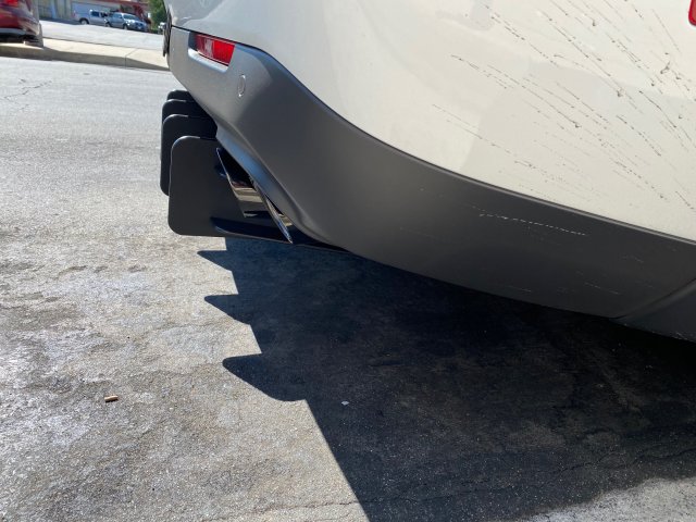

I installed the entire ZL1 kit with my daughter on our driveway, not difficult at all, we did it with only one side up. I've put up some photos below:

I see you did not do the rear side skirts.
#3113
26
62
Los Angeles
2020 Dodge Challenger Widebody Redeye
You mean the mud flaps? If so I've got them but I have to get it up on a jack remove the wheels so I can drill the extra screw in to hold it tight.
If you mean the ones that connect to the bumper, they don't have them for the widebody.
11,710
19,832
Damn, those verticals are as big as rudders
