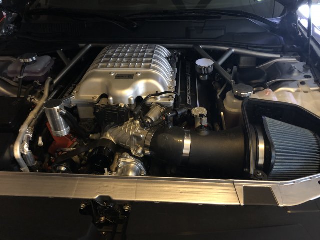

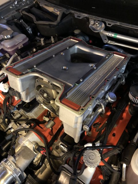

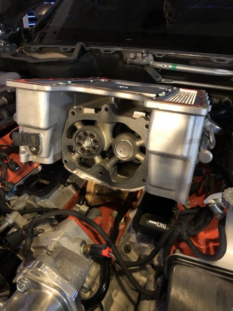

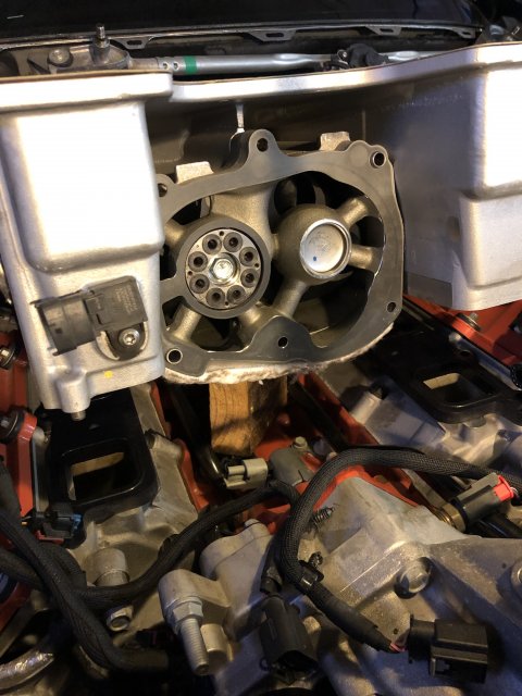

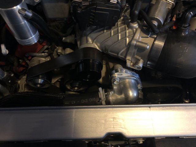

I decided to finally do a 2.85 TBA Machine pulley ( Thanks to Todd owner of TBA Machine for a great deal ) , F1 1000cc injectors ( Thanks to Keith owner of Fuel 1 for a great deal ) & have it retuned. After the Track Rental day a couple of weeks ago & my best time was 10.241 on stock boost, I figured that I have just about got the most of stock boost with my set up & I wanted a little more to run 10.0's & maybe high 9.'s so here we are. The install went pretty smooth after watching a lot of different vids on it & @Speedy's vid on his install, good info !
Got the retune yesterday at Peitz Performance , job well done to Alex ( owner & tuner ) & the whole shop !
It's a Mustang Dyno which will show a little lower readings vs a Dynojet Dyno, but it made 732 hp / 688 torq. - 93 octane tune. If we don't get rained out this Friday ? I'm excited to see what # it will run at the track , to me that's what really matters.

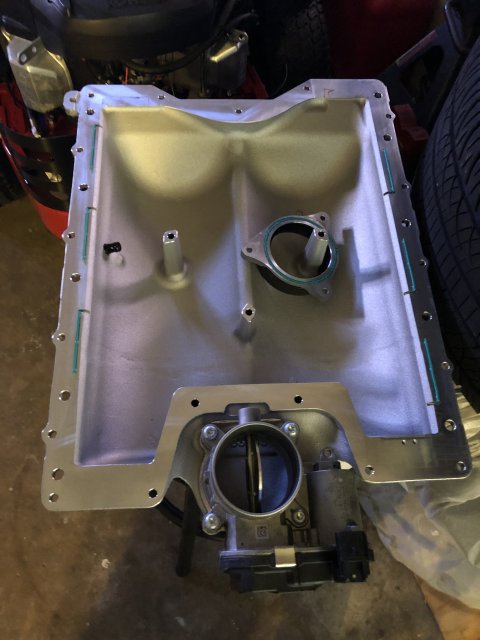

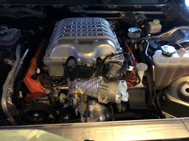

Look how purty the underside of that S/C lid is... 'Damn near eat off of it...

Congrats on the upgrade, the install is really pretty simple once you get in there. I've not heard of the TBA pulley but it appears to be decoupler like the Litens?
5,185
9,647

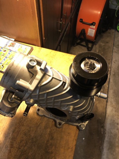

Thanks Speedy, the TBA is not a decoupler pulley , it the hub is octagon shape , as well as the pulley & does all of it's driving force with the hub center on the pulley center , the 6 screws just hold the pulley on the hub, hope that made sense. I went with TBA over the Litens or Metco pulley bc of cost , design & I already have my lower stock damper pinned.
It would make a good ice cream bowl. :LOL:

Really nice looking. That's the factory snout and elbow, just with the new pulley, right?

Yep makes sense. I like the decouple setup on the Litens to keep pressure off the blower when you shut the throttle, but lots of folks run fixed pulleys no problem as well. Glad to hear the crank is pinned. Cheap insurance.
Thanks & that's correct.

FYI , I don't know if anyone else has had this issue but the shop that did my tune was showing me they have had several Litens pulley failures , where some snap ring had broke or came out & the pulley would walk back into the snout , so just keep a eye on that ?
7,027
18,202
I've heard one report about something like that. Litens asked for the pulley back to do an analysis and (from memory) something was done incorrectly during install. Also, they I've seen they now include a spacing washer so I assume some of the blower snouts that are cast aren't all exactly the same. I was told to measure mine after install to make sure I had 2-3mm between the pulley and the snout. Mine was on the close side at 2mm but was good. I bet some hit the snout at install and that might be what the shop was seeing. Mine's been on there a year with LOTS of WOT hits. Probably in the hundreds at this point :sneaky: The pulleys the same design as OEM.
OK , good to know that, I haven't heard of issues with Litens pulley until the shop mentioned it, so prob. some difference between each snout or one of those fluke things ?

Great pics. I can't believe how clean the blower looks compared to the one they took off my car.
Thanks Jim, maybe with great DA it will run 9's but I don't expect it to be the norm.
It might be so clean bc it only has 6900 miles on it & in March I will have had it 3 years, lol.

Everything on mine was coated in oil. Mine had about that on it when they changed the blower. The mechanic had no problem with installing the spacers when he saw them after seeing all that mess. LOL
Not exactly one off but something folks need to be aware of. Cast parts aren't all that precise.
