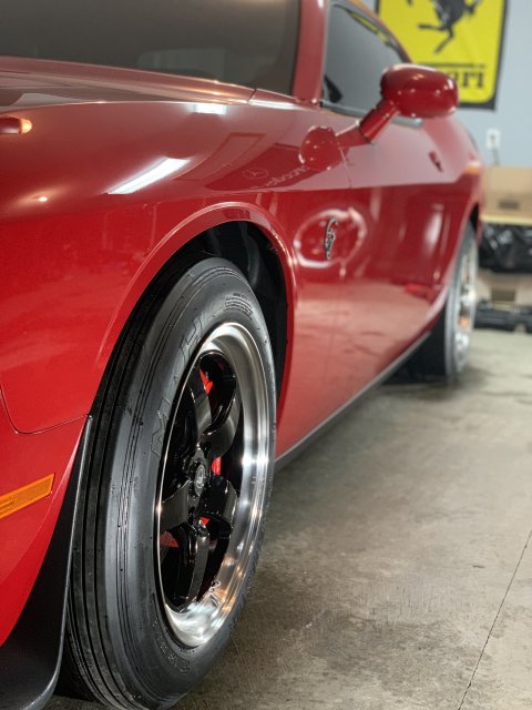

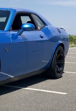

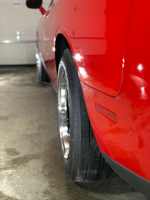

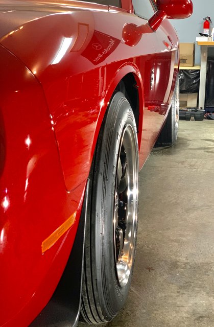

Here's some different angles to show the rear orientation:
F749FBBB-A09D-4200-9A50-7CC29FF2BCFB.jpeg 0A3253F7-0E31-42C9-B896-495E26CF9314.jpeg DB5944FA-5E57-4F85-A72E-8A4EB013BB2F.jpeg

Good am Matt. Looking at your rears it certainly seems that moving outboard by an inch would be easy, especially with the flares. Just to give you an idea, here they are already mounted. I’d love to go with the 315’s but I dont want to have to hammer that rib. Thanks for the input.
