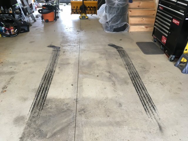

My burnouts are now pretty short now that I have a linelock - but those P-zero's will put out a lot of smoke in under 20 seconds; 5B101F2E-88FE-4132-B89A-59D21EB1EE2B.jpeg
( filled my 40x 52 shop so much I couldnt see in the door! )

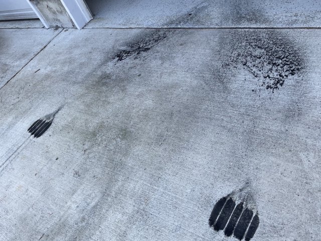

Mine clawed her way out of the garage too.
This was the first time it jumped to the left on me… and as you can see it was getting pretty close to the toolbox and my truck was parked in front of the garage… so I had to thread the needle.
