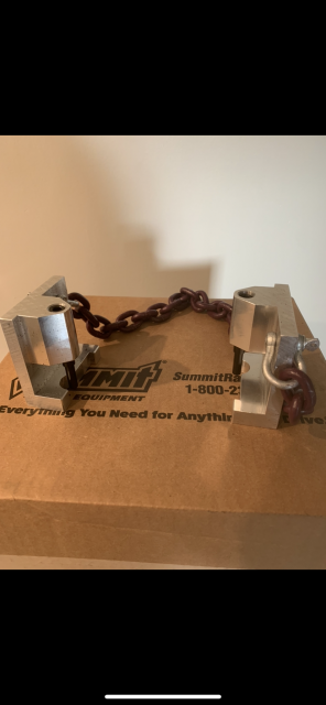

Got a new tool a while bsck, worth its weight in gold for a one man show

do tell more???

Bingo! That was faster than I thought lol

Goes under the side of the lid on each side, and a dowel screws down into the open bolt hole to secure it. Use an engine hoist, and blower comes straight out. No more fender elbow dents!

Now if I could just get my hands on one!

It’s made by snap on for the dealer, I’m surprised they even released the tool to me

Do you have a snap on part number? I’ll check with my guy and see if he can get his hands on one?

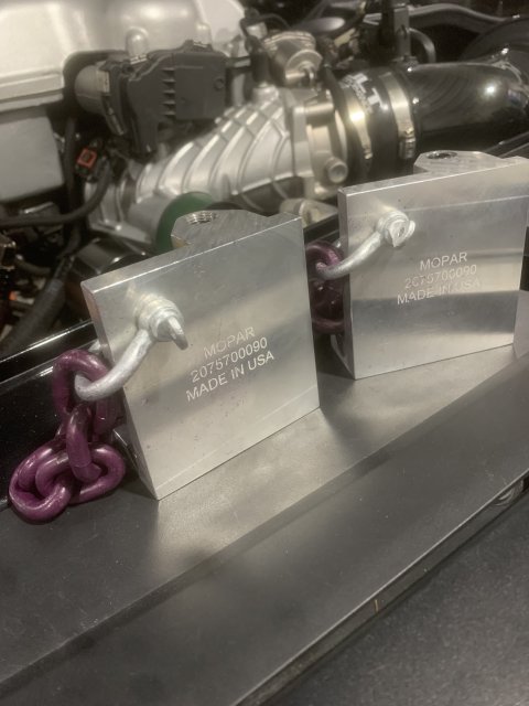

It’s on mopars dealer tool site, let me take a pic of the part number on the side

No sir, that was just from other parts lol

Didn’t know it even existed, was looking for other specialty tools on their site and came across it. It’s genius

Thanks for the picture of the part number I will check tomorrow.

Anytime man!
