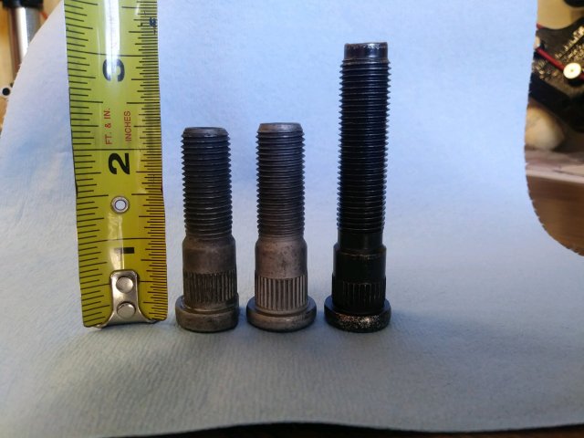

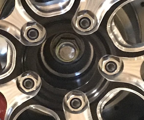

3,496
11,247
Missed this. I have Dormans. Shop uses them. I like the open lugs that you can see the length of the stud. The NHRA likes that too. 8D301B22-40F5-4450-BFC9-FFE23726356C.jpeg

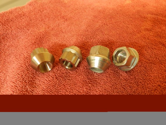

No, that rule does not directly apply to a conical seat lug nut with a bulge. It's the "mag shank" that is the weak point in that type of lug nut. A conical seat lug nut will not "pull apart" like a mag shank lug nut.
. VS

More specifically, the studs would not come completely out of the TI lug nuts on the left in this pic on my car, but if the OEM Demon lug nuts on the right would fit a weld wheel : EVERY thread in that lug nut would be engauged on the stud since they are relieved (look close). 100% safe.

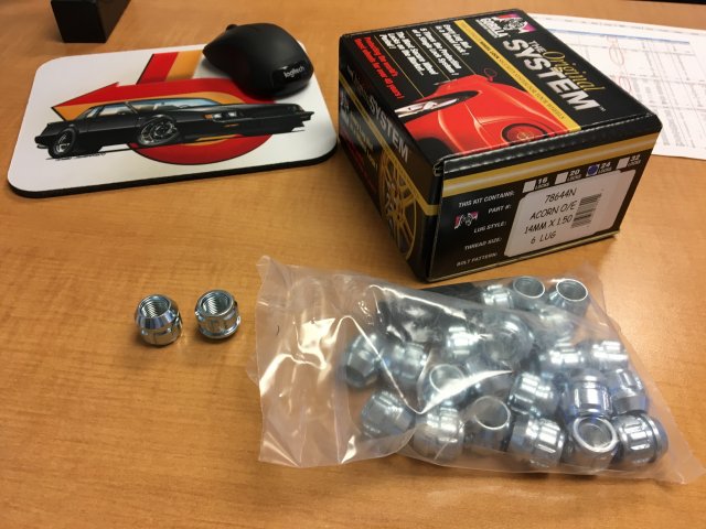

I bought these to use with the Welds

What is the second stud? It looks like about 1/16th of an inch longer.
One is the OEM front and one is the OEM back out of my Demon along with the Dorman stud.. Based on photos I have, I am pretty sure the longer OEM stud is the back.
