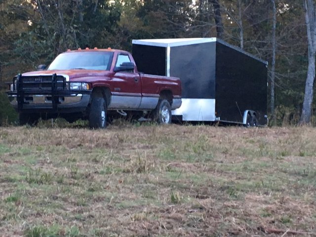

2001 24 valve 6 speed, just put 100hp injectors in over weekend.. i want a new one but just can't let this truck go!
I plan on a 6sp when it needs a clutch. where did you get your 6spd trans from if it was new?
