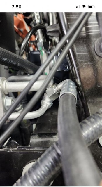

Hey all. Longtime reader of the forum..
Shop is installing this kit on my trackhawk, this is the one made by Dave Spurlock. Shop has run into the following issue, pictures attached.
The fittings on at least two of the hoses won’t articulate with the hardware they’re intended for due to the directions/angles of respective connection points.
Mr Spurlock recommended we use a vice to bend the fitting to get it to articulate with the port coming off the chiller.
Anyone installed this kit before, did you run into this and were you able to bend the fittings?
View attachment 139654 View attachment 139655
I have AI Chiller on my 2017 HC. I installed & recharged system myself and had no issues as you had. It works great.
