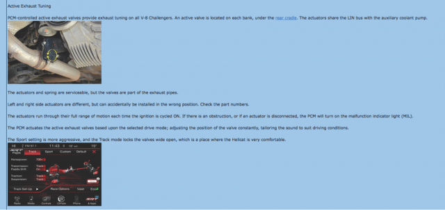

I believe I read somewhere that in track and sport it opens fully after you hit 3 MPH. I’ll see if I can find that article tonight.
Definitely notice the difference when its running in echo mode.
The sport setting is a little louder but track mode locks the valves open.
http://www.activeexhaustsolutions.com can help with keeping them open.
