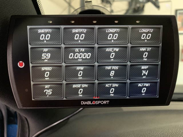

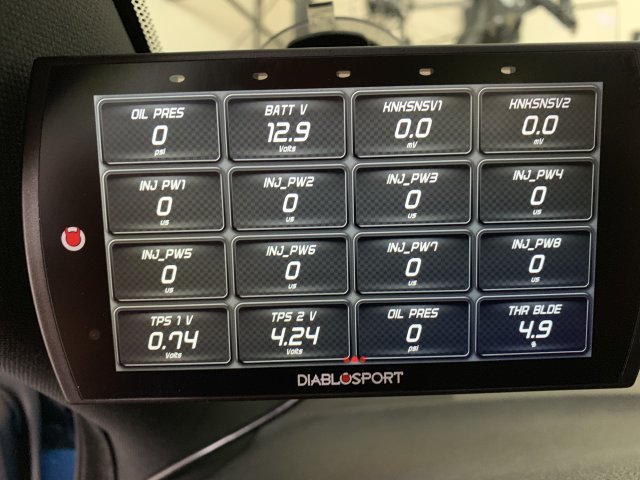

BAPs are fine as long as you are watching your logs, watch fuel pressure, injector duty cycle, fuel trims, etc. Compare them old to new, keep an eye on things and you will be fine.
Would you mind sharing the PID's you monitor regularly? Some of the acronyms d9nt compute with me

Are you Diablo or HP?
Diablo. I think I actually bought my T2 off of you a while back on the other site lol

AA0B1734-0A23-403F-AB37-DE9EC8458F66.jpeg 889E1765-CD94-4AC0-9501-ECCDCBBEBD79.jpeg
