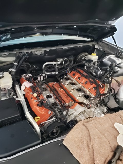

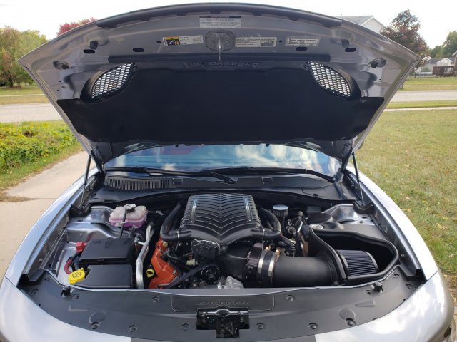

So I had decided to buy a Whipple 3.0. Lethal had the best price on the stage 2 and Labor day weekend had 10% off so I decided to order it. I also had to pick up the 3 bar map sensors 53010887AA and worried they would not make it on time being they had been back ordered but they made it before the blower. It showed up last Saturday and I started the install. Taking the stock one off isn't too bad but was more time consuming putting the new one on. The map sensors are in different places so there are wiring extensions to add. @16GoManGoHC2 did the install awhile back and he added a plug to the temp sensor extension (moves from rear to front) so he didn't have to cut into the factory wiring harness so I did the same. He also told me to buy M6x40mm bolts to work with the blower spacers. The kit comes with a 3.75" pulley but I bought a 3.00 griptec for it. To my surprise the belt that came with it, 59.4 fit perfect. I had the spacers and bigger idler pulleys which I had to run a 58.5 on the stock setup which the stock belt is a 57.9. Ran into a couple things with missing 2 O rings for the coolant fittings and I was missing the wrong size nipple fitting for the blower to the valve cover on the passenger side. I would have probably had it done Sunday if not for that. Monday I was able to find some O rings at Ace hardware and was able to rig up a fix for the fitting until the correct one made it Thursday
Monday it started right up with a tune Jon sent. 2nd test drive it threw a code for the big 112mm tb but Jon made an adjustment in the tune and all has been fine since
