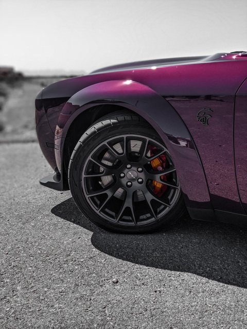

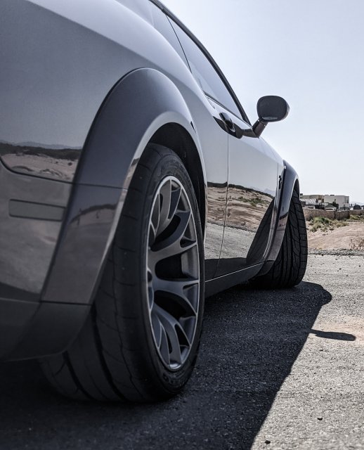

Quick update: I went ahead and went with NITTO NTrrr2 315/35 r20 on the rear and NITTO NT G2 305/35 r20 in the front. I have to say that it's a night and day difference from the stock tires. So far so good. PSX_20200902_154137.jpg PSX_20200902_155128.jpg
