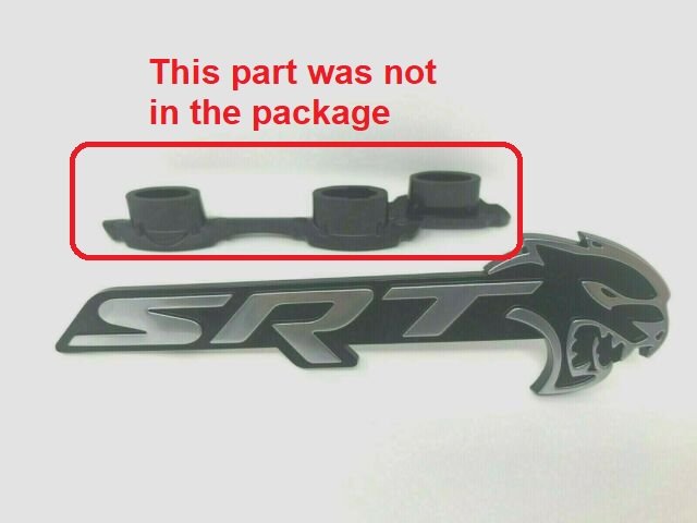

I'm doing the grille update over Christmas, but it looks like the grille badge I bought has posts that are meant to receive speed nuts from the back side, like the previous badges have. But upon further investigation, it appears my order from Steve White Motors did not include this new part, circled below.... dang.

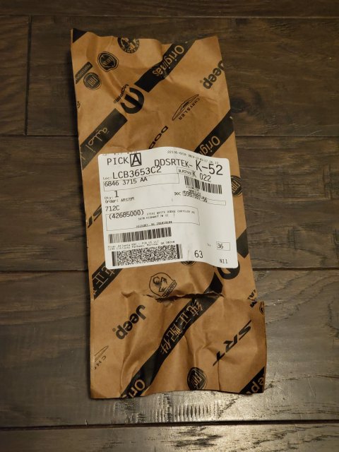

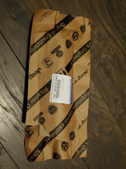

Just to follow-up on my previous post:
The 2019 Charger Hellcat Grille Badge is part 68463715AA. The package is supposed to have both pieces in it, as shown above.
I received a package with only the one piece, and there are apparently other mis-packed ones as well. Steve White Motors has found more like the one they sold me. The parts were mis-packaged by FCA. Steve White Motors is sending me a replacement now, after screening their stock for bad ones.
The only way to tell if it is a complete part is to open the package. These are packed in an opaque brown envelope.

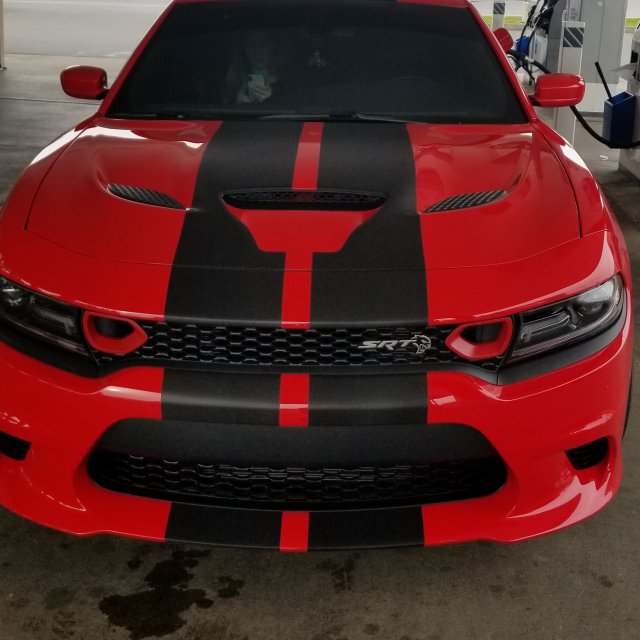

Done, didn't have to remove anything. Took all of 15 minutes. Slid the backplate through the snorkel slowly then positioned it just right before popping the badge in.
FYI, you gotta seal the badge through the plate or else someone can just walk by and pull it out.

Looks great!

Looks great I had my snorkels hydro dipped in carbon fiber along with that black bumper piece.
Still haven't issued the new grille yet though.
