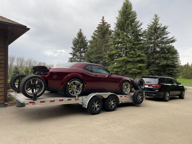

It appears that David has a very good eye. The original pic did have the car too far forward. I was checking straps today and positioned the car for 10% tongue weight and it looks al lot like the pics you guys posted. This is why I ask you guys for help, you seem to really know your chit! Thanks again! (Yeah, I know it's not level in the pics, it's on the jack. I did have to change the ball mount to one with more drop.) IMG_0051.jpeg

It appears that David has a very good eye. The original pic did have the car too far forward. I was checking straps today and positioned the car for 10% tongue weight and it looks al lot like the pics you guys posted. This is why I ask you guys for help, you seem to really know your chit! Thanks again! (Yeah, I know it's not level in the pics, it's on the jack. I did have to change the ball mount to one with more drop.) View attachment 134265

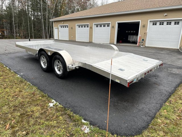

It is a CL special. 20' Rance 7k alum trailer with an alum deck, 1350#, lighter than the trailers with a wood deck. 2-3 years old.
I only have a 1/2t, an I am concerned about pulling the car 350mi each way, not to mention some rolling hills. I ran across a 20' steel 10k tilt trailer less than a year old. It had a 12k winch added. Cost the same as this Rance. Better trailer all around, but weight was 3K# before the winch. I wanted it bad, would have been a no brainer if I had a 3/4t, sadly I had to pass.
One thing someone pointed out, if you have a trailer with a capacity way beyond the load, you will get a harsh ride. A friend transports his HC on a 14k trailer, he has to stop a lot to tighten the straps. Maybe because of the harsh ride?? As it is, I estimate 5600 on the 7k trailer, I like that ratio. In Aug I'll have better data.
